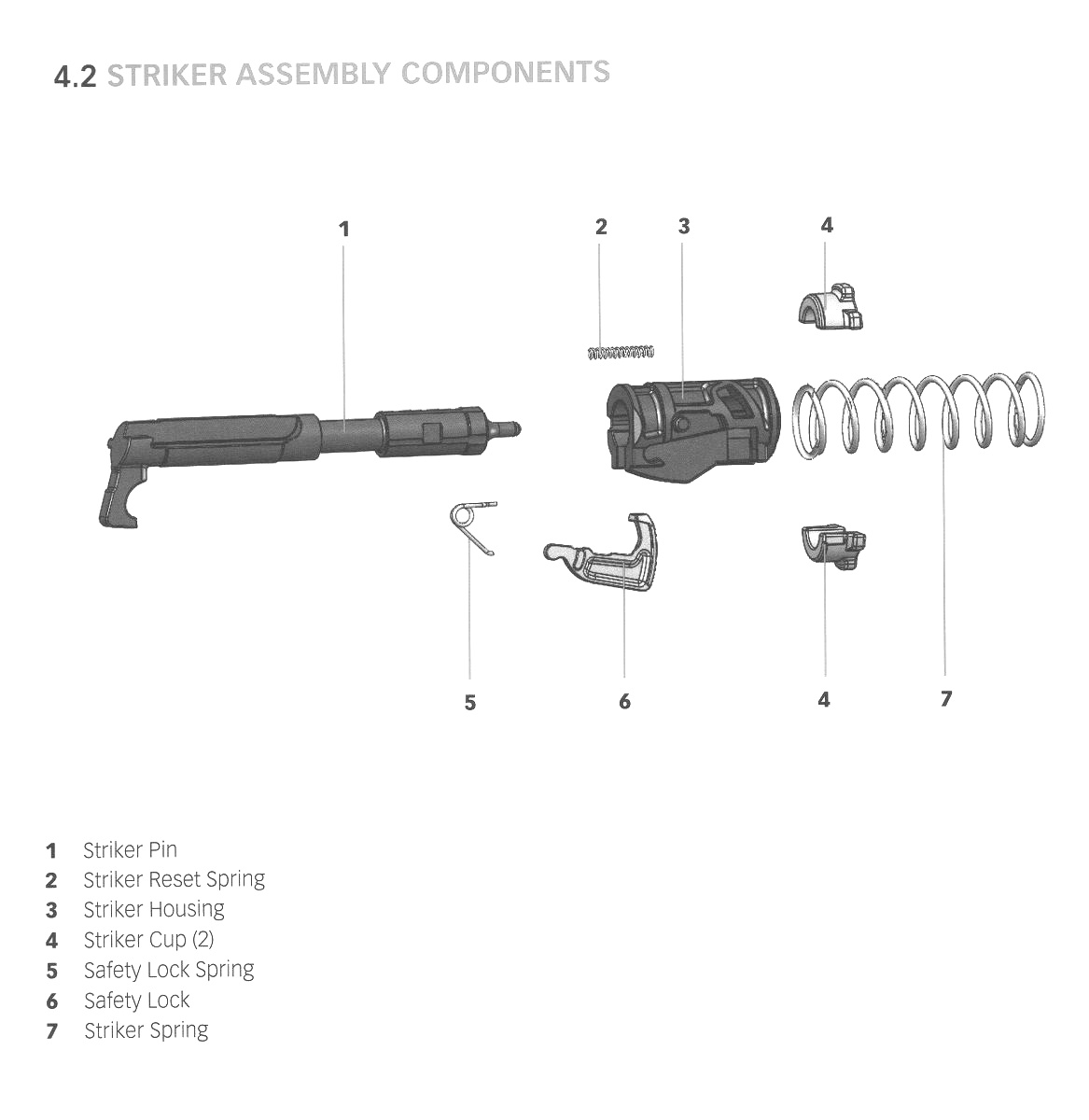

2A4Cook Posted April 17, 2025 at 12:09 AM Posted April 17, 2025 at 12:09 AM If I understand it correctly, the issue is that the gun is pre-cocked, and the sear can fail if it was molded badly where just a little jostling can release it and let the firing pin move forward. MIM blows. That said, I've owned several, swapped the fcu's between different frames, carried them, and never had an issue. I still have one.

Euler Posted April 17, 2025 at 06:59 PM Author Posted April 17, 2025 at 06:59 PM On April 16, 2025 at 07:09 PM CDT, 2A4Cook said:→If I understand it correctly, the issue is that the gun is pre-cocked, and the sear can fail if it was molded badly where just a little jostling can release it and let the firing pin move forward. ... That's not true. There's a safety on the striker, similar to a firing pin safety in a hammer-fired pistol, that doesn't release unless the trigger is pulled. It's the part labeled "6" below.

Dumak_from_arfcom Posted May 31, 2025 at 11:07 PM Posted May 31, 2025 at 11:07 PM Apparently the issue has been discovered. Gray Guns can replicate the issue. In an unknown number of 9mm P320s, the takedown lever is the incorrect part. The 10mm/45ACP takedown lever was used. This, combined with improperly placing the slide on to the frame can result in minimal sear/striker contact and make the gun prone to an uncommanded discharge. To properly attach the slide to the frame the slide needs to be pulled all the way back and the slide stop engaged. Then the takedown lever rotated upward and the slide stop disengaged. If one pulls the slide back, and then rotates the takedown lever without first engaging the slide lock, it causes the sear to not go fully into position. At least, that is how I understand the issue. Link to video from Gray Guns: https://www.instagram.com/p/DKP_3hkz9jN/

Euler Posted June 1, 2025 at 03:54 AM Author Posted June 1, 2025 at 03:54 AM (edited) On May 31, 2025 at 06:07 PM CDT, Dumak_from_arfcom said:→... At least, that is how I understand the issue. Link to video from Gray Guns: https://www.instagram.com/p/DKP_3hkz9jN/ The video Gray Guns references is this one on YouTube. (requires login) I'll summarize/explain the videos. I'm not sure they did a good job themselves. To have a truly accidental discharge (firearm malfunction), 3 things have to go wrong.The striker safety (part #6 in my previous post) must be defective or the striker safety spring (part #5) must be damaged or missing.A 10mm/45acp FCU (with the associated takedown lever bar) must be installed in a 9mm/40s&w/357sig grip.The firearm must be reassembled from field strip without activating the slide lock. The P320 has numerous safety features to try to make the firearm idiot-proof. As I posted previously, the striker safety prevents strikes if the trigger is not pulled, just like a firing pin safety on a hammer-fired pistol. (FWIW my understanding is that the striker safety is stamped, not MIM'ed, and that no striker safety has been found to be defective in any "spontaneous discharge" events.) The P320 ordinarily prevents magazine insertion if the firearm is not assembled correctly. Part of reassembling the firearm correctly requires locking the slide back, not just holding the slide back, while returning the takedown lever to the assembled position. However, 10mm and 45acp magazines are larger than 9mm, 40 S&W, and 357 SIG magazines, so a takedown lever bar that blocks the larger 10mm/45acp magazine could allow the smaller 9mm/40s&W/357sig magazine to be inserted. The 320 is also designed to prevent sear engagement if the slide lock is not engaged while returning the takedown lever to the assembled position. However, possibly due to engineering tolerances, sometimes the sear might engage, anyway, but only marginally. Marginal engagement could allow spontaneous release. IMO: SIG tried to make the P320 idiot-proof, but (if this reason is why firearms are apparently malfunctioning) humanity rose to the challenge. Edited June 2, 2025 at 05:48 AM by Euler

Euler Posted July 26, 2025 at 07:14 PM Author Posted July 26, 2025 at 07:14 PM (edited) In a 32-page report dated 30 August 2024, the FBI examined several M18 (P320 with a thumb safety) sidearms for the Michigan State Police after one of their motorcycle cops had an "uncommanded" discharge. The most significant finding (IMO) is that it's possible to jostle the firearm enough to unseat the safety lever spring (the part labeled 5 in my previous post), thus defeating the striker safety. Such jostling could occur when wearing the firearm while running, jumping, and rolling around on the ground. The FBI used a specially modified test firearm to force the sear to release (without pulling the trigger) and showed that the safety did not always prevent a discharge. The second most significant finding (IMO) is that it's possible to make the sear release by rocking the slide from side-to-side while applying a small backward pressure on the trigger. Jared Yanis (Guns&Gadgets on YouTube), was able to replicate that behavior with both a SIG P320 and a Glock 43X, so it's not particular to SIG. (Yanis reads the whole FBI report in a 45-minute video.) It's an interesting issue, but not necessarily relevant, since it still needs something to apply pressure to the trigger, which supposedly isn't happening. The FBI did some other testing, like smacking the P320 a few hundred times in various places with a mallet, which didn't cause a discharge. The specific firearm that had the discharge also had an unusual wear pattern on the sear, which may have been due to a manufacturing defect or possibly a problem with the material itself. Other MSP M18s didn't appear to have the same problem. The FBI report combined with the Gray Guns/LFD Research videos does present a complete set of facts that SIG should probably address. Edited July 26, 2025 at 11:22 PM by Euler
davel501 Posted July 26, 2025 at 07:33 PM Posted July 26, 2025 at 07:33 PM On 7/26/2025 at 2:14 PM, Euler said: In a 32-page report dated 30 August 2024, the FBI examined several M18 (P320 with a thumb safety) sidearms for the Michigan State Police after one of their motorcycle cops had an "uncommanded" discharge. The most significant finding (IMO) is that it's possible to jostle the firearm enough to unseat the safety lever spring (the part labeled 5 in my previous post), thus defeating the striker safety. Such jostling could occur when wearing the firearm while running, jumping, and rolling around on the ground. The FBI used a specially modified test firearm to force the sear to release (without pulling the trigger) and showed that the safety did not always prevent a discharge. The second most significant finding (IMO) is that it's possible to make the sear release by rocking the slide from side-to-side while applying a small backward pressure on the trigger. Jared Yanis (Gun&Gadgets on YouTube), was able to replicate that behavior with both a SIG P320 and a Glock 43X, so it's not particular to SIG. (Yanis reads the whole FBI report in a 45-minute video.) It's an interesting issue, but not necessarily relevant, since it still needs something to apply pressure to the trigger, which supposedly isn't happening. The FBI did some other testing, like smacking the P320 a few hundred times in various places with a mallet, which didn't cause a misfire. The specific firearm that had the misfire also had an unusual wear pattern on the sear, which may have been due to a manufacturing defect or possibly a problem with the material itself. Other MSP M18s didn't appear to have the same problem. The FBI report combined with the Gray Guns/LFD Research videos does present a complete set of facts that SIG should probably address. I was following a discussion where a lot of these are higher round count pistols. 4k+ rounds. Probably explains the stronger reaction some departments have had if this is happening to their gun guys.
