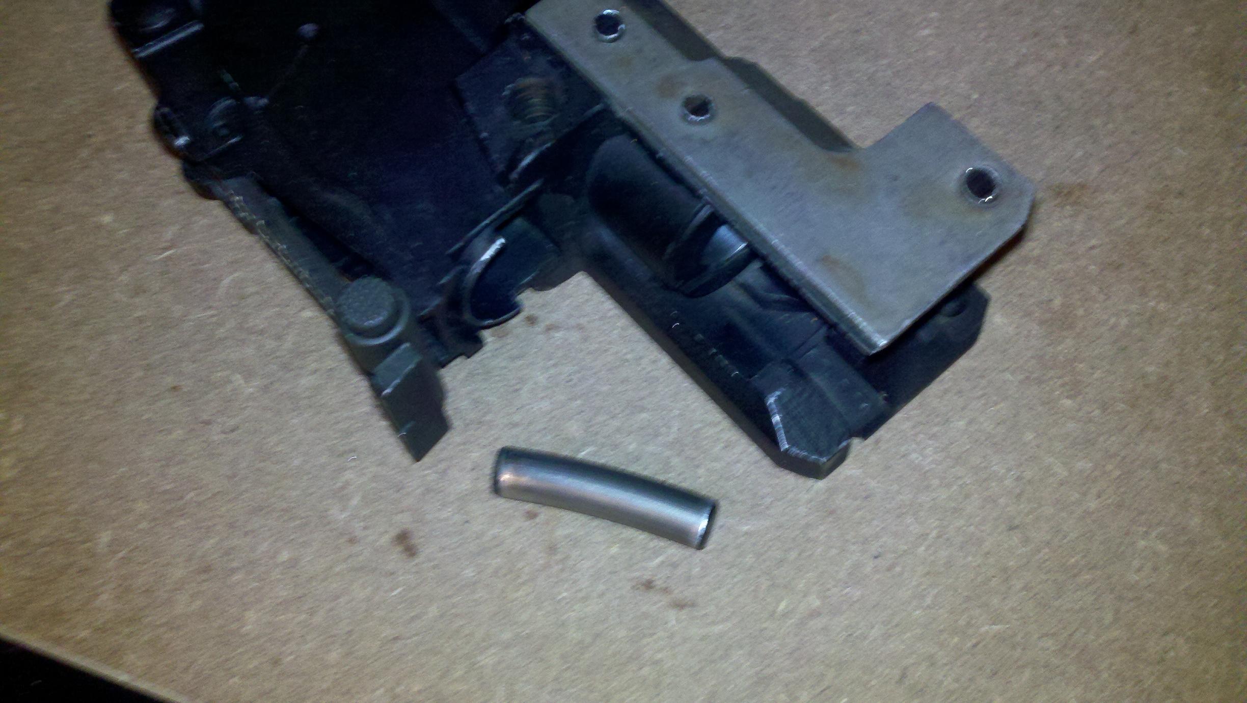

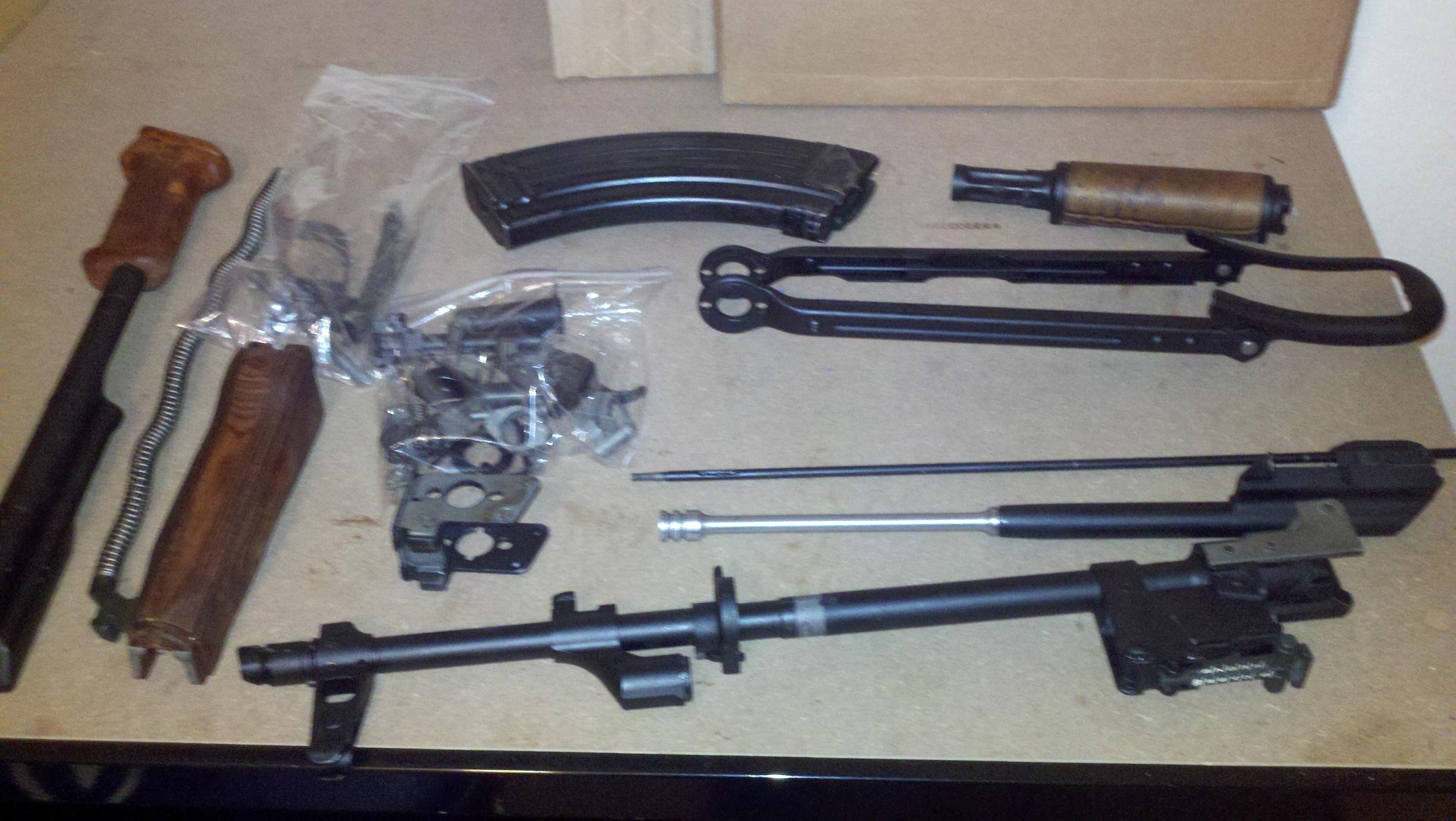

Here's the kit I'm starting with. The finish on these parts looks new. The gun was probably never used before it was cut up.
I had to use my 12-ton press to remove the barrel pin. And it is bent...

Don't you just love that ping sound when that pin finally lets loose? Thats a nice looking set of parts. Was it a choice set from somewhere? The last Polish I saw was ridden hard and put up wet.

Wow. The kit does look pretty fresh. As for the barrel pin, I had the same problem on my PSL kit when I started. Barrel pin didn't want to budge. Heated up the trunion with a torch (just a little), and it popped out relatively easy.
I bought this kit maybe 3 or 4 years ago from gunthings.com ak-builder.com I think. It cost something like $279.
I also have 2 other kits, both Romanian AKs that I bought back then, not in as good condition as this one.

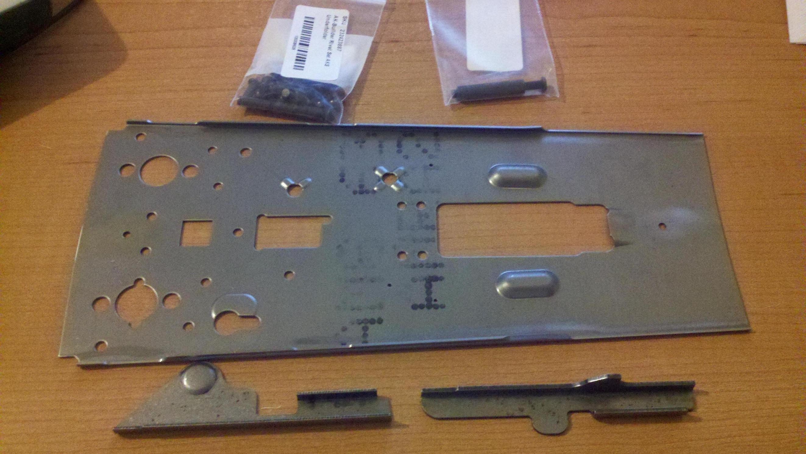

Here's the receiver flat, rivets, support pin, and rails. I'm going to have to visit a friend who welds when it comes time to weld the rails to the receiver. I'm pretty sure I can handle all the rest.

That the flat has the upper rails already bent will save you some time and hassle (particularly in terms of fitting). Matching numbers parts kits come at a premium because they almost never present problems with headspacing. If your barrel is original to the front trunnion (which they always are) and if the bolt carrier and bolt match the front trunnion ... you should have no problem with headspace. Once you put that pin back in (or a replacement), that barrel will be within a couple thousandths of where it was originally. The approach suggested by Sleeper would give some peace of mind. Also, a lot of AK builders have headspace gauges they will loan you.
Yeah, I paid an extra $5 for the flat to have them pre-bent. I have a jig for that too, but felt better about having it done and it was cheap enough.

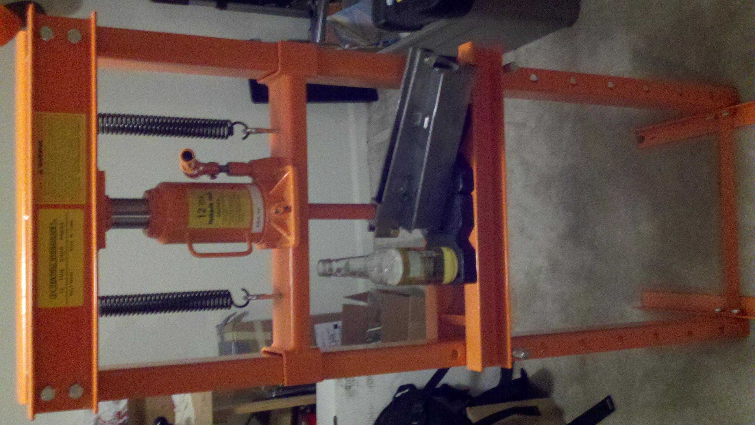

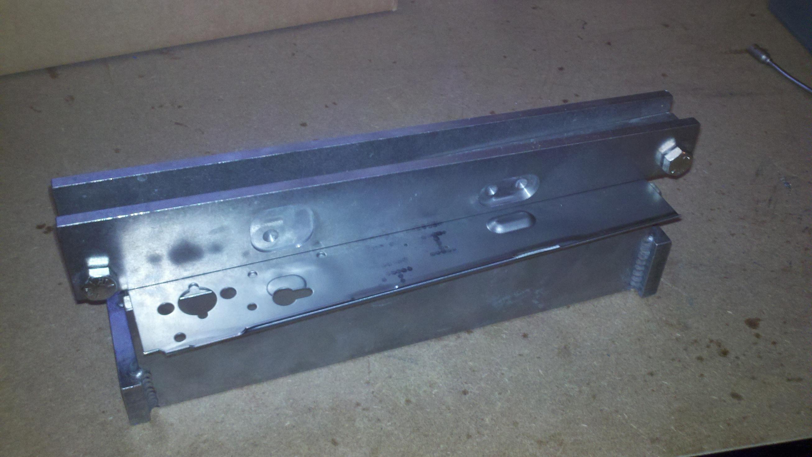

Here is the jig and flat, in the press ready for bending. The beer is there for...uh, scale. Actually, I'm fortifying myself slightly as I'm nervous about possibly making a $40 mistake during my first ever bend attempt.
Here it looks, pre-bend. There is about a 16ths of an inch play either side of the flat, which makes me cautious that it's lined up correctly.

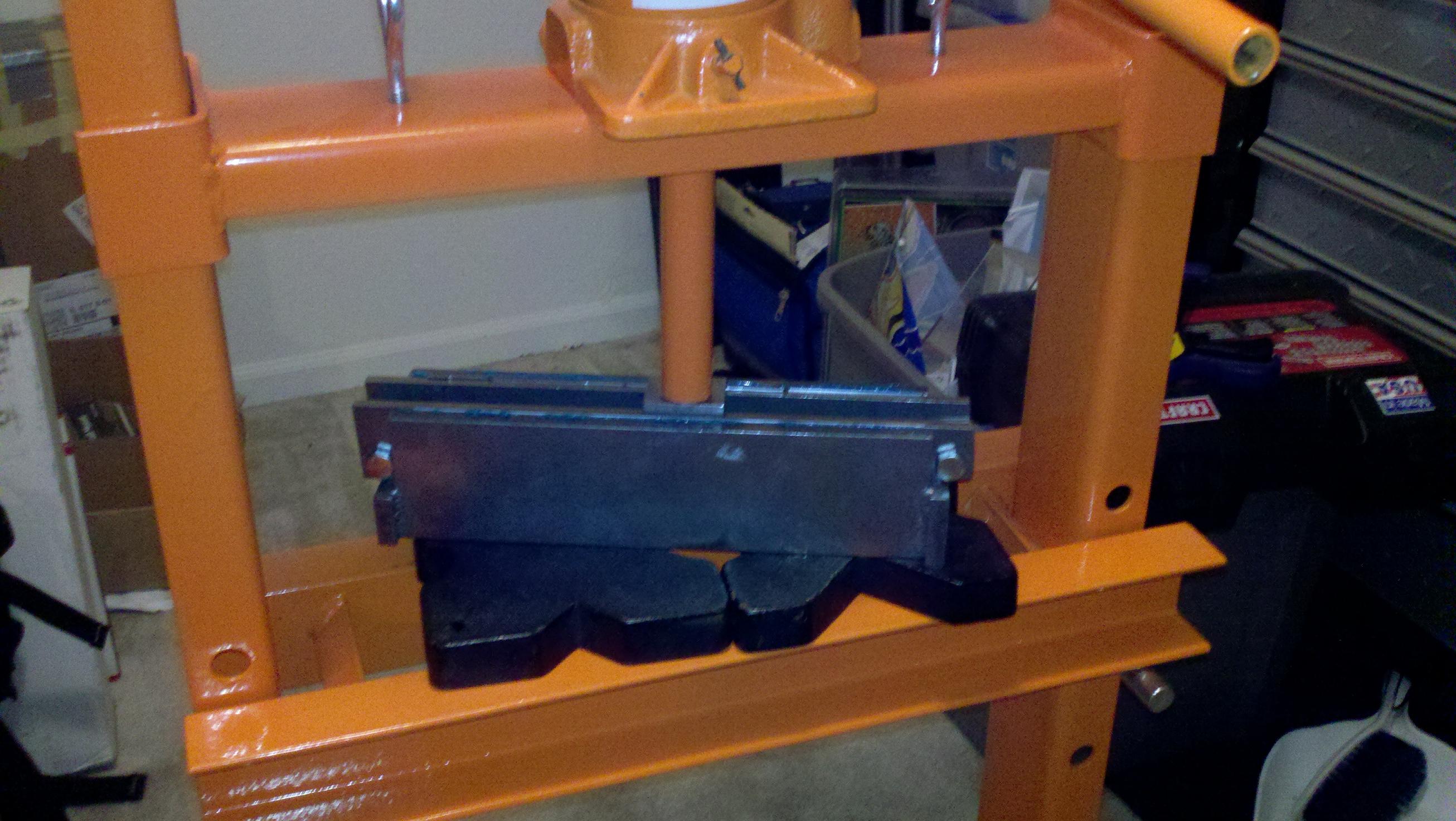

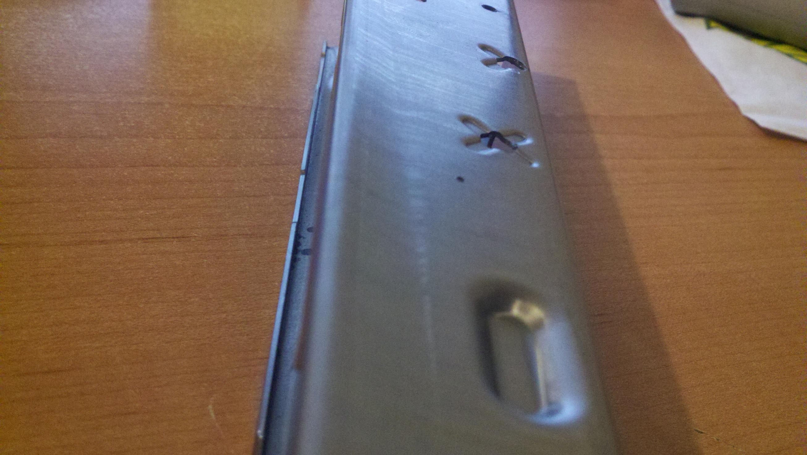

And here we are post-bend. It actually took longer than the timing of the posts makes it seem as the file upload from my phone took longer...

OK, all is not well in paradise. You should be able to see the crease in what should be a flat side. This happened on the other side as well. I didn't bend in small enough increments. I'm going to have to flatten that out.

#29 Federal Farmer
    David Lawson
  • 9,346 posts
  • Joined: 03-January 07
Posted 09 April 2012 - 10:25 PM
Good news! I think I got it flattened out...close enough anyway...

#30 Yas
  • 3,960 posts
  • Joined: 07-February 09
Posted 10 April 2012 - 09:11 AM
Did you grease the Flat before trying to bend? I found Spray White Lithium Grease worked well.
