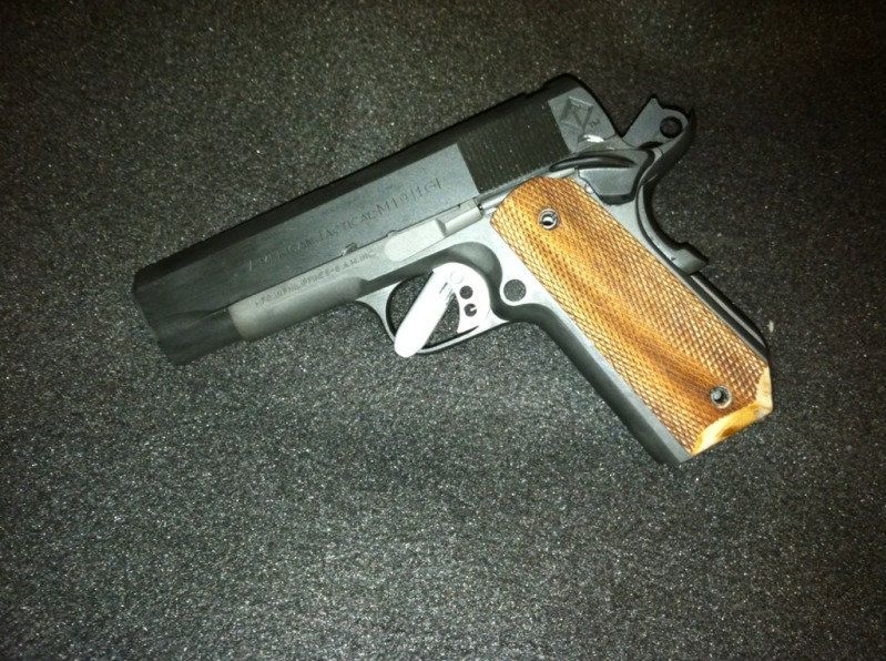

Straight out of the box and dripping

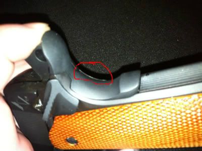

Area that needs blended a bit better

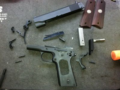

Stripped and ready for the chop shop

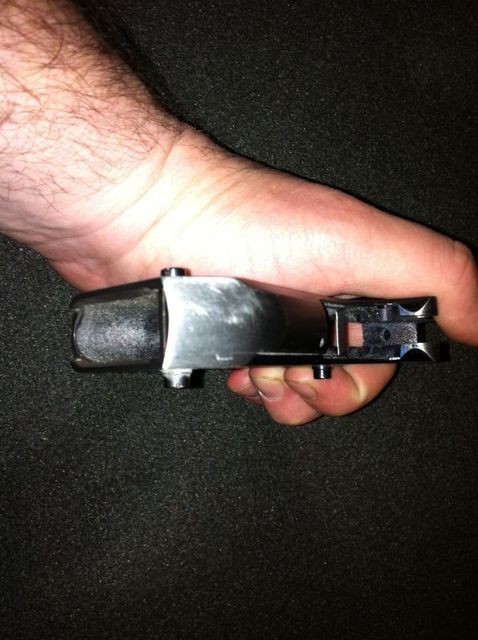

Drilling new hole for bobtail MSH (Ed Brown jig works great by the way...I can mail it to someone if they'd like to borrow)

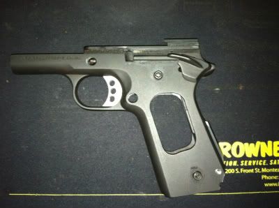

New thumb safety fitted, bobtail MSH fitted and majority of frame area ground away
It will be a few days before I start blending the frame, so no updates for a bit.

Vaden, I agree it is odd to grab one at first, but a standard length 1911 main spring housing typically digs into the meat of my palm at just the wrong place to me. I can cure it 3 ways:
1. Put a heavy chamfer on the edge of the MSH, which I have done on my stainless Springer
2. Add a mag well/longer MSH, which I have done on my Springer Operator
3. Bobtail which also cuts down profile for carrying the gun

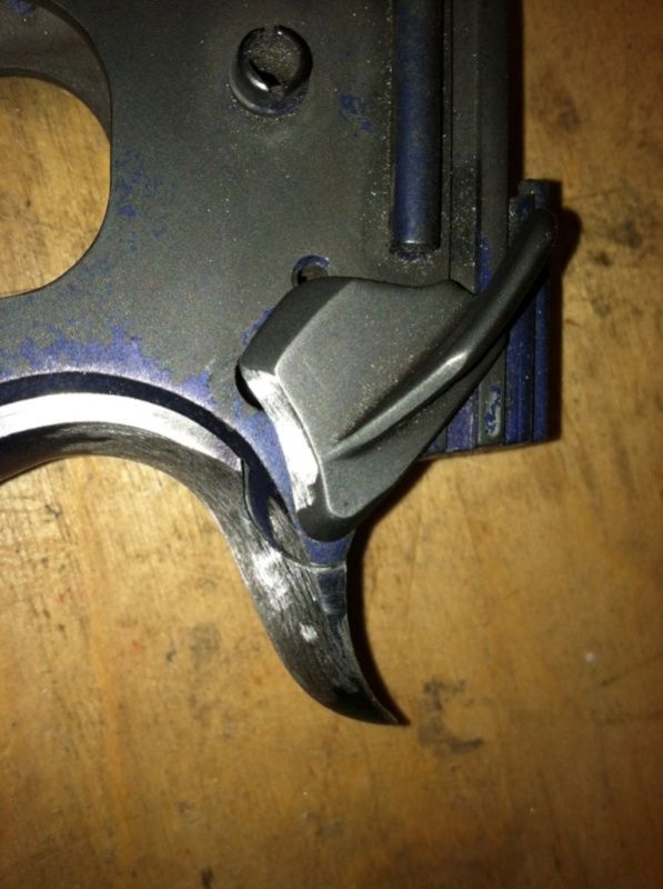

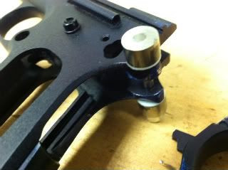

I've been busy and haven't done much...but the budget went up. I really didn't like the way the grip safety was inset into the frame and to fix the look of it was going to require removing more material from the frame itself. I checked the safety against a couple of samples in my buddy's shop and found that the factory one was somewhat thinner than the ones he had on hand.
So another $33 went to a Smith & Alexander .220 radius grip safety, same one typically used for Springfield guns based on how the folks in Geneseo leave the frame ears. I used hardened steel buttons as a guide to get the frame close and will then polish/fit until it's right. You can see some silver marks on the ears where the grip safety is rubbing just a bit, just a little more hand work and that part will be done.

  • Joined: 09-March 09
Posted 10 April 2012 - 11:02 PM
Bobtail is blended!
#13 milq
  • 1,291 posts
Posted 14 April 2012 - 04:21 PM

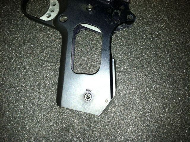

New grip safety is fitted and rough shaped, it required a LOT of blending due to the heavy chamfers that they put on the tangs at the factory. Now I'm going to clean the grit out of it and reassemble, function test, adjust as needed and wait for bluing.
I had trouble resizing this image any smaller, sorry for those that have trouble with it.

Made a last minute decision to bead blast the gun and parkerize instead of bluing it. So, it's still non-glare but the finish should hold up longer under holster use...the slide is very close to being black but the frame is a bit lighter in color. Function and safety checks are all 100% and I just have to fit the sights and wait for the grips to arrive.
I was going to pre-fit the sights, then remove and refinish the gun but the parkerizing tanks were hot today and he won't fire them back up for another month or more. If I really screw up the finish I can re-do it next month I suppose, the finish is smoother than I expected so if I do refinish I will blast it with aluminum oxide to rough it up a bit more before the re-park.
Hopefully this is the resized pic, photobucket is giving me fits.
Oh yeah...ignore those grips, they are a set that was warped and I tried to see if I could make them fit, got a little happy on the belt sander.
