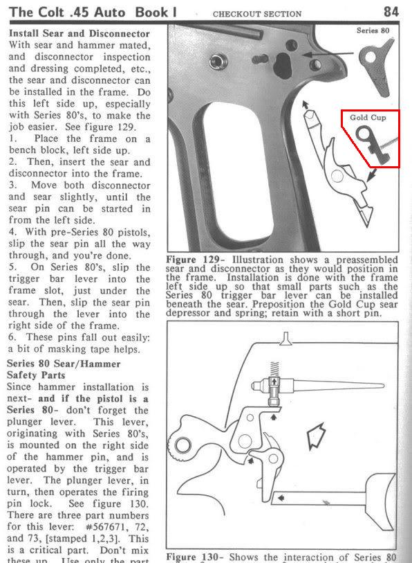

Hey AB! While we're discussing springs - ever had a Gold Cup frame apart and dealt with that little sear depressor spring that's unique to the Gold Cups? I haven't as yet but from what I've read they're a BASTARD to put back together.
Nope, not had it that long or into it that deep. Thanks for the heads up though, I'll do some research before tying into it!
I'm gathering info on it myself. What makes me worry is it sounds like some gunsmiths take 'em out and pitch 'em. I'm not sure I'd like that done to MY gun. I did find a good picture of the sear depressor but can't seem to find it now. I should have bookmarked it when I discovered it. Here's a couple pages from the 1911 forum that shows it.
http://forums.1911fo...ad.php?t=270852
http://1911forum.com...ead.php?t=23969
It sounds like the trick to easing the reassembly of the sear depressor is to use an old sear pin cut to length to use as a slave pin. I've seen others say they use a Q-tip stem to hold things in place while you insert the sear pin.
