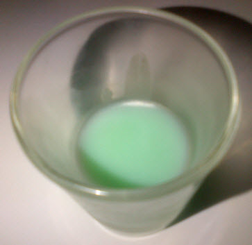

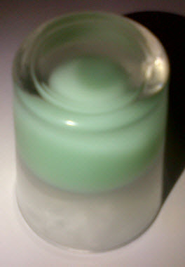

So I was making lunch and while digging through the fridge I came across the shot glass of Frog Lube. It was in there for about a week. I was surprised to find it had hardened up into a solid, just like it did in the freezer. My fridge is setting is 3, out of possible 1 through 5. It says 3 is the recommended setting.
Anyway, still no sign of clumps or grit. In fact, it looks just like the tub of paste that I have, only a slightly lighter color. Here's the pictures:

I'll watch it as it softens up, but I expect it will "melt" back into it's liquid form without any clumping, just like it did with the freezer experiment. I wish I had more time to experiment with this, but I'm pretty confident that you just got a bad bottle. Maybe somebody was trying to stretch their product before selling it to you by cutting it with some other ingredient?

It returned to liquid and looks just like the pictures in my previous experiment.
