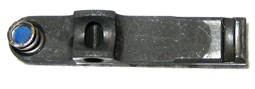

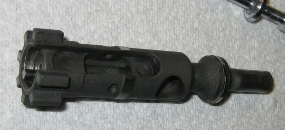

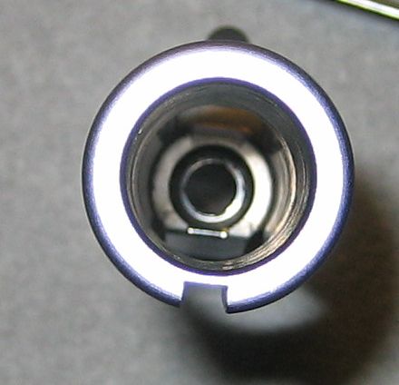

Ultrasonic Cleaner Review!
This is a review of the Sharpertek Ultrasonic Cleaner CD-3800 XP PRO which is basically a small jewelry cleaner with 30 watts of cleaning power. Sells for about $45.
http://www.jewelsmal...ulclcdasij.html
The interior tank on this unit measures 6 × 3.5 × 1.5 inches. Which in hindsight is too short for an AR-15 bolt carrier, but should handle most pistol barrels with ease. There is a slightly larger unit (60watts) which sells for $200 (currently on sale for $90), and measures 6.75 x 5.38 x 2.75 inches which might just barely clear a stripped BCG. The tank in this case is stainless steel and so far cleans up easily by wiping clean with a paper towel. It does scratch if you put metal objects into the tank. There is a supplied basket for small items that you can use to prevent scratches to the stainless tank, but be warned that the plastic basket aborbs the ultrasonic waves and reduces the power of the unit by 30%.
Plastic basket for small items.
The unit has one power setting and uses a fixed variable timer to shut off the unit when the cleaning cycle ends. The timer has 5 settings of 90seconds, 180sec, 280sec, 380sec, 480sec. Simply selected the duration of the cleaning cycle and hit start. The unit will shut off when the countdown timer hits zero.

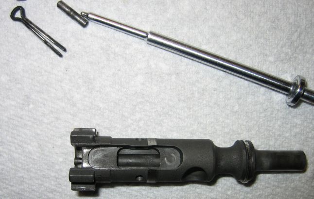

For this review we will be cleaning a chromed bolt carrier group. The bolt was already wiped down once, but still has some stubborn carbon in hard to clean areas. Cleaning solution is 1 part MPro7 gun cleaning solution and 4 parts warm distilled water. The makes of MPro7 recommend 1 part MPro7 to 9 parts water for use in ultrasonic cleaner so I could use less solution in the future, but it is easier to eyeball a 1:4 mix than a 1:9 mix. Distilled water was heated in a coffee mug in the microwave separately from the cleaning solution and then later mixed. Solution was comfortably warm to the touch and not burning hot.
Before Pictures:
Bolt Face and front of carrier. Notice the carbon rings on the chromed face of the carrier.
Side of the carrier. Notice the carbon imbedded in the machining marks.
The stripped carrier was about 1/3 submerged in the tank as it had to sit at an angle because it was too long to fit in the tank. It was set to a cleaning cycle of about 5 minutes in a mixture of warm distilled water and MPro-7 cleaning solution. The bolt and other small parts were put into the plastic basket and cleaned in the dirty solution for about 8 minutes.

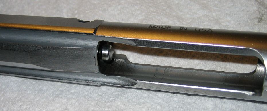

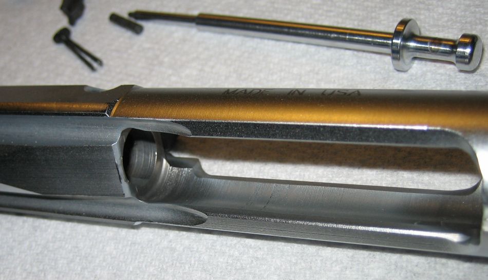

The results are below:
Close up of clean bolt
Close up of clean bolt face
Clean Extractor

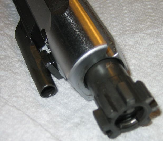

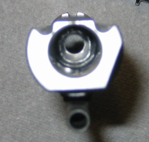

Clean Carrier Face. You can see down into the gas cylinder. Note the hard carbon still remaining at the bottom. Some of this had to be scrapped using a carrier cleaner tool and there is still carbon left.
The firing pin was covered in carbon which seeped into the oil from the still dirty firing pin channel. Now it is very very clean and completely degreased.
Carrier Side After. Remember the carbon in the machining marks? They are all gone now.
A view from the tail end of the carrier. You can see it is clean until you get to the bottom and there is a ring of hard carbon left over.

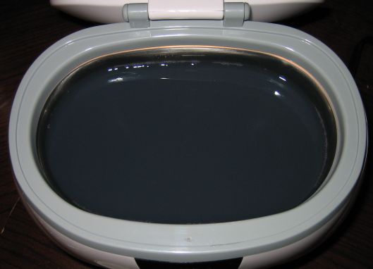

The cleaning solution after we were done. I tried to filter this stuff through a coffee filter, but the particles are so fine that the coffee filter was unable to catch anything. I've written into the makers of MPro7 to find out what they recommend to use to filter this mess out. Right now I have the fluid sitting in a bottle and am hoping that the particles will eventually settle to the bottom and I can skim the clean fluid off the top.
According to the directions for using MPro7 with an ultrasonic cleaner, I am suppose to let the cycle run for about 15 minutes. But for the purposes of this demonstration, the shorter cleaning cycle still proved that it can get the parts cleaner than I could if I were cleaning these by hand. The ultrasonic cleaner even with the MPro7 gun cleaner was unable to cut through the hard carbon deposits in the shortened time I had given it. But the softer carbon and grease on the other surfaces were completely gone. After pulling the parts from the warm/dirty solution and drying them I gave all exterior surfaces a wipe with an oil soaked patch. By the time I was done, the patch was STILL white. The Q-Tip I used to oil the inside of the bolt also remained clean. But the Q-Tip used to oil the inside of the carrier picked up carbon from the remaining hard carbon rings.
Overall I have mixed feelings about the results. I will probably resoak everything at a later date using clean solution in an effort to get rid of the remaining hard carbon spots on the tail of the bolt and inside the carrier. I know this is a futile gesture as these areas will just get covered in hard carbon again the next time the gun is fired, but it would be interesting to see just how clean this cleaner can get these impossible to clean areas.
This has been an interesting experiment and I hope all of you have enjoyed the results.
edit: In a year or two if the price on this unit drops under $300. It'll probably be my next Christmas gift. :rolleyes:
http://www.jewelsmall.com/heulcl.html

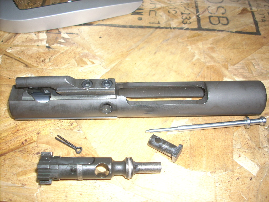

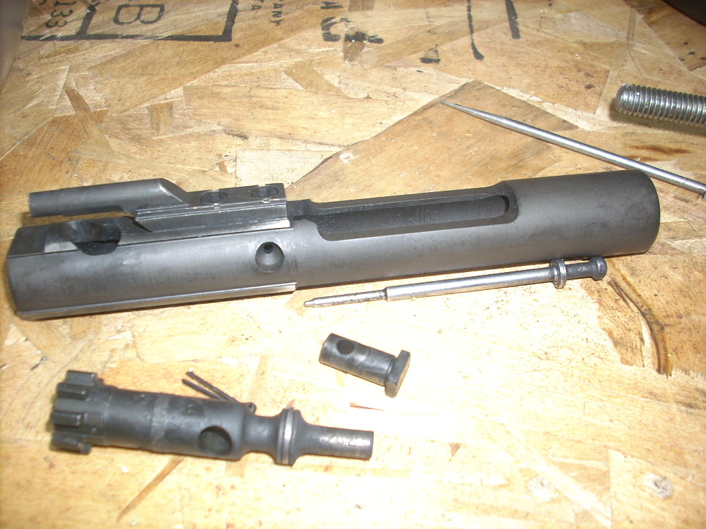

This thing is awesome I don't know how I ever lived without it before!!!!
After 6 min in the cleaner with Hoppes #9 solvent:DSCN0557.JPG

Does anyone know the flashpoint on Hoppes #9? That is the only thing I would worry about because the heater in the machine gets the solution pretty darn hot!!
Chad you may want to call first I think I got the last one at this store.
Look at the inside of the bolt carrier in the before pic (black) and the after pic (shiny) it is awesome.
I am going to keep my eyes open & put the word out to all my friends in the manufacturing business to find a big one for rifles.
I could take it to the local range & charge $10 each to clean guns after a competition. I know I would pay that to save myself 1/2 hour when I got home.
